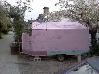

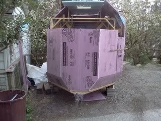

Today the roof became a flat one. Fairing the two shapes (nose and roof) together was going to mean basically carving the inside and outside out of a giant hunk of foam for no major benefit. I already have enough headroom inside, so I cut out the ribs and the curb for the vent. Next is to trim the panel and bevel the edges so it drops into place - it's there now mainly to support the tarp since the rain is rolling in again. The strip screwed on at an angle gives an idea of the approximate angle of the slope.
The front is trimmed but still needs to have the edges sanded. I've got a dock billet (big rectangular hunk of foam) that I'm going to use to fair that flat panel in the front. I'll sand it round and use it as a plug to glass up a clamshell that opens up a shelf at the wide spot. It looks like I'll be able to get two 20lb LPG bottles in there if I do two doors hinged on the outsides and latched in the middle. A single piece means just one bottle in the middle. The lower section will be open at the bottom since that's where the tongue jack will be. That way, when I'm towing, the jack and bottles will be faired in to keep the drag down.
GPW has mentioned wheel pants: well, this one will have bottle pants !
A thought occurred to me as I was sliding the roof panel up - when I first started poking around this forum, I would NEVER have though I'd need a stepladder to reach the top of whatever I wound up building. :lol:
Well that and how silly those little wheels look under that expanse of foam.....

Postby Wobbly Wheels » Sun Apr 22, 2012 10:08 pm
Hehe...if anyone's reading and it doesn't make sense - I edited a post from this morning with pics. Pc Historian was replying to something I had posted then deleted about having problems fairing the roof and nose together.
I just eliminated it by flattening the roof since I didn't really need the extra height anyway.
The main issue was getting a compound curve out of a flat panel - even kerfed in two directions, it wouldn't match both the lateral curve of the roof's camber and the longitudinal curve of the top of the nose. Plus, it would have to match where the sides of the nose close in. This way, I can develop the whole shape from triangular & trapezoidal panels on the sides and rectangular across the front. Easy peasy, albeit with a 'faceted' look. I'll just have to figure out how many panels to do it in to get the degree of roundness I want....or I could do it like a Bucky Ball !
